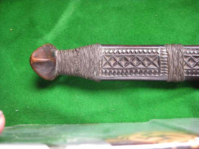

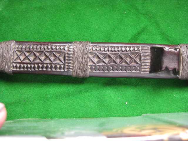

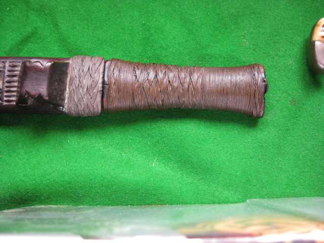

Hi guys ,what do you make of this one 19th cent Shona ?

Sorry about pics will try harder .

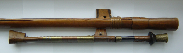

Hi
Yes, a 19th or early 20th century Shona knife "Bakatwa". Looks good.

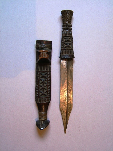

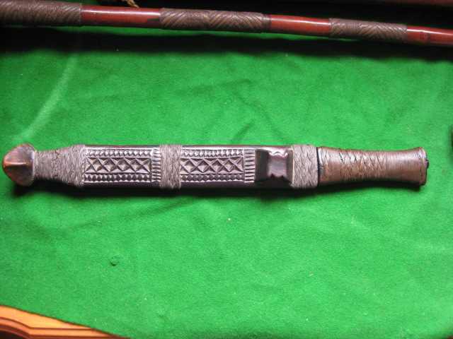

Yes
A very nice Shona dagger. Here are my two for comparison.
Congrats

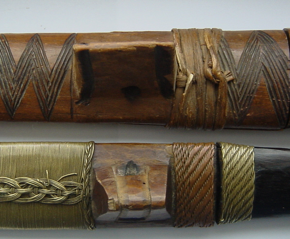

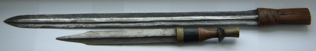

Posts: 6,023

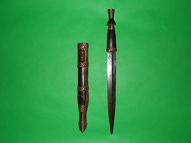

There is little doubt that many of these are Mashona and related people. Lately I have been thinking about the many styles of these knives. I wonder at the foot print of the style and influences. Shona may have become one of those catch all collector terms like Manding and many others. Compere this Rwandan sword to the knife. The blades are very different in shape, both have one side black with iron scale decoration, but look at the projection on the scabbard. This feature the same form and decoration only the Rwandan one there is the use of charing can be seen on Shi? weapons Eastern Congo. Could there be some origin linking areas from present day Zimbabwe through Zambia and Eastern Congo to Rwanda. Is this feature found in Tanzania? or is that were the seme takes over?

Thanks for your help guys ,nice knives Lou posting better pics .

Good point about the Rwanda sword, Tim. The similarities in the scabbards and concept are clear.
The Zulu had a number of offshoots that went north, in the early 19th century, one getting as far as the southern edge of Lake Victoria seemingly. So its quite possible for the Shi sword/knife to derive from the Shona pattern. The Matabele, who used some Shona weapons, were of course originally derived from a Zulu migration.
