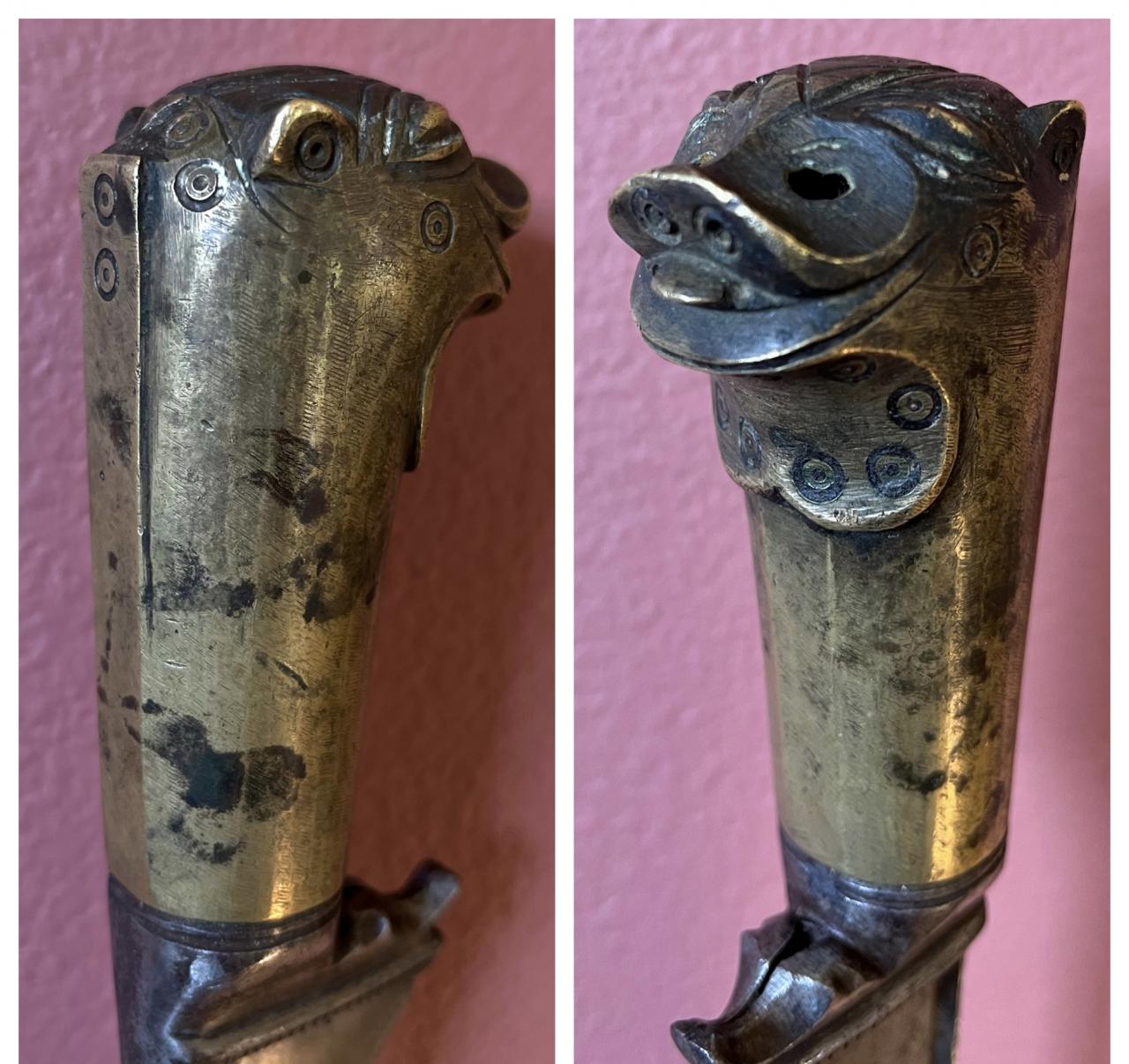

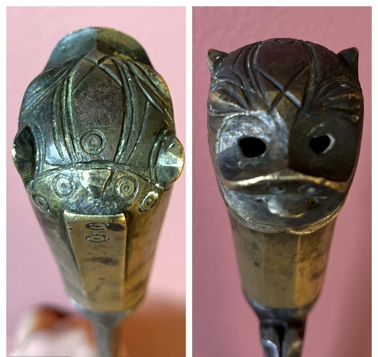

A recent find. Not really in my field, but I couldn’t walk away from the knife show without buying something.
I’m guessing it’s Indian based on the Makara(?).
Old 24th April 2026, 07:44 PM   #20
Posts: 4,732
Kino,
Can you post better pics of the hilt and pommel from different angles. It's not a makara as best I can tell, but perhaps something interesting from the feline family (judging from the ears).
Regards, Ian.

Posts: 534
The circle and dot patterns make me wonder why not Northern Indian/Afghani?
Old 26th April 2026, 07:40 PM   #22
Posts: 4,732
The feline (?) pommel in side view first reminded me of a Ceylonese lion such as depicted on the Sri Lankan flag: mouth open and prominent upturned nose. Front view not so much. This pre-historic lion is also shown without a mane. Perhaps a civet or other member of the cat family.
The T-spine certainly suggests northern India/Afghanistan/Pakistan region.

Posts: 1,036
Default Apologies for the delayed response Ian
I hope these photos help.
