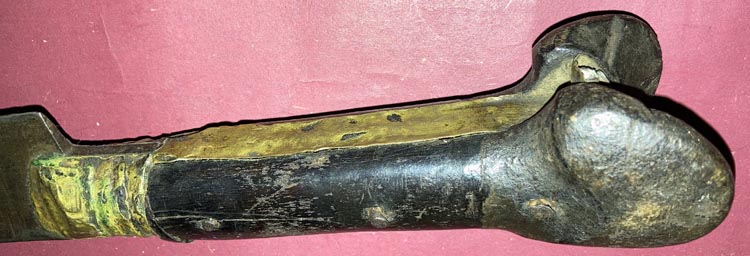

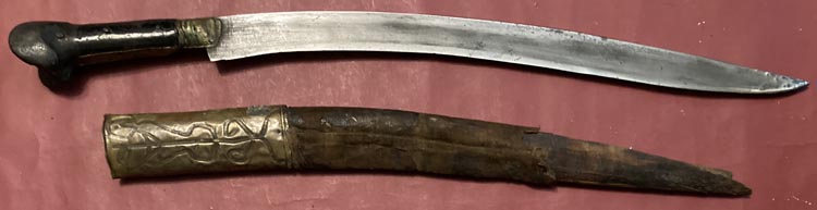

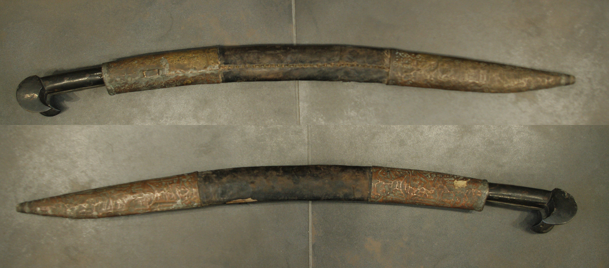

Hi All,
I was wondering if anyone could tell me where this no frills Yataghan comes from. Perhaps the design on the sheath throat (which looks to me like a bird in a tree) is a clue. The blade measures 19.125" (48.5775cm) and has a slight T-rib. There are no maker's marks or other inscriptions. The hilt scales are wood that have been painted black (now very worn). Three steel rivets secure the scales to the tang. The backstrap (top part missing) between the scales is brass, as is the ferrule which also shows the remains of a very plain ricasso. Despite the obvious wear, blade and hilt are still quite solid. The sheath is wood with a brass throat and a black painted fabric center section. The fabric & the wood are both in poor condition and the brass throat shows an area where a suspension lug may have been. I believe that the bottom section of the sheath also had a brass covering which unfortunately is now missing. Its unprepossessing nature notwithstanding, the sword is very well balanced and pleasing in form. In use it would be as effective as more Princely Yataghans.
Sincerely,
RobT

Hi All,
Last month I posted a request for info on the origin of this yataghan. Despite over 500 views there has been zero response. I have been a Viking Sword member for a long time and this is the first yataghan post that I can recall seeing that didn't generate a healthy response. I find it hard to believe that this piece is so odd that nobody has seen its like before. It is a very well made blade despite its lack of bling. I am currently cataloguing my collection and would appreciate origin info so I can correctly categorize the piece. In my opinion, because of the member knowledge base, Viking Sword is far and away the best source for reliable info of this type. Any help would be greatly appreciated.
Sincerely,
RobT

Normally these are identified by the inscription, or by distinctive mounts, having neither this is impossible to place. Sorry mate, sometimes that happens.

Default Thanks For The Responses
David R
You have a good point. Save for the motif on the sheath throat, my piece is certainly without any inscription or decoration. So, unless somebody knows of an area where yataghans are made without embellishment, I may be out of luck.
Athanase,
I don't know what your yataghan looks like but I don't believe the one I have was meant as a souvenir for the following reasons: The blade on mine is well forged and well shaped and the hilt is solidly mounted to the tang. The wear patterns on all components indicate use and carry. And finally, there is an absence of any bling. Why would anyone go to all the hard work of making a combat ready item as a souvenir and then not provide it with the eye candy (no matter how tawdry) designed to catch the tourist's eye? Perhaps you could provide a photo of your yataghan for examination and comment? You may have judged it too harshly.
Sincerely,
RobT

Of course, it's an authentic 19th c yataghan, but as David said it's almost impossible to say more than that.
Your yataghan could be from anywhere, between the Balkans, Turkey or even Syria...

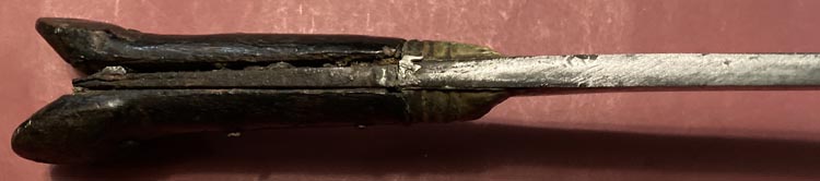

You should post a good photo of the blade, I cannot see any back edge / flat spine on your photos...

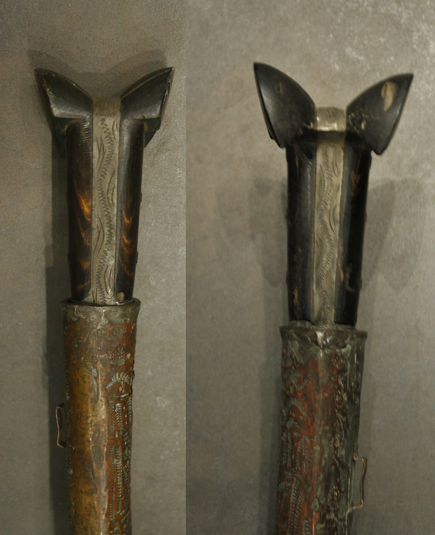

Pictures of my Yatagan for comparison.
I just cleaned the scabbard with soap to remove the dust, but I haven't touched anything yet.
The scabbard is made of wood covered with leather sewn with copper wire and covered with thin sheet of engraved copper. The tip of the scabbard is made by a copper thimble. The handle is in horn and white metal. The blade is made of steel, maximum 3mm thick. It is a little sharp, but the groove is very badly hollowed out.

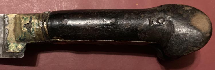

Default Spine, T-Rib & Tip Close-ups

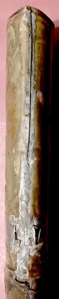

I have made close-ups of the spine at hilt, T-Rib and tip of my blade. Caliper measurement of the spine at hilt measures 11/32" (between 8 & 9mm, .34375 decimal inches). The T-Rib tapers distally from the hilt and ends 1-7/8" (44.45mm, 1.875 decimal inches) before the tip. I can't recall ever having seen a yataghan with a T-Rib before but maybe I haven't been paying close enough attention (they are usually so darn expensive that I only glance at them).
Athanase,
Your English appears to be quite good. Are you sure the spine on yours is only 3mm? I ask this because that is well under 1/8" and otherwise, your blade looks OK to me. Certainly, based on the photos alone without the measurement, I would be inclined to buy it if the price were right.
Sincerely,
RobT

I wil take some risks and say that your Yat is from Bulgaria or Turkey...
Old 7th February 2021, 06:14 PM   #13
Balkan karakulak yats are frequently fairly crude. They and many longer Bulgarian/Greek shepherds knives are made by local blacksmiths for less well off locals. most have integral bolsters, which the Turkish ones tend not to, having formed sheet metal, usually decorated or embeded with colored stones extending partway up the blade..Like yours (which has no stones).
Longer Balkan shepherds knives can look very yat-like.
In other words, without specific indicators, yours has mixed signals, Balkans Or Turkey sounds reasonable (or both).
p.s. - something simple, like a photo of the stitching on the scabbard may help too. Turks tended to use a sort of ladder with short horizontals wound with wire (example from a sabre below)

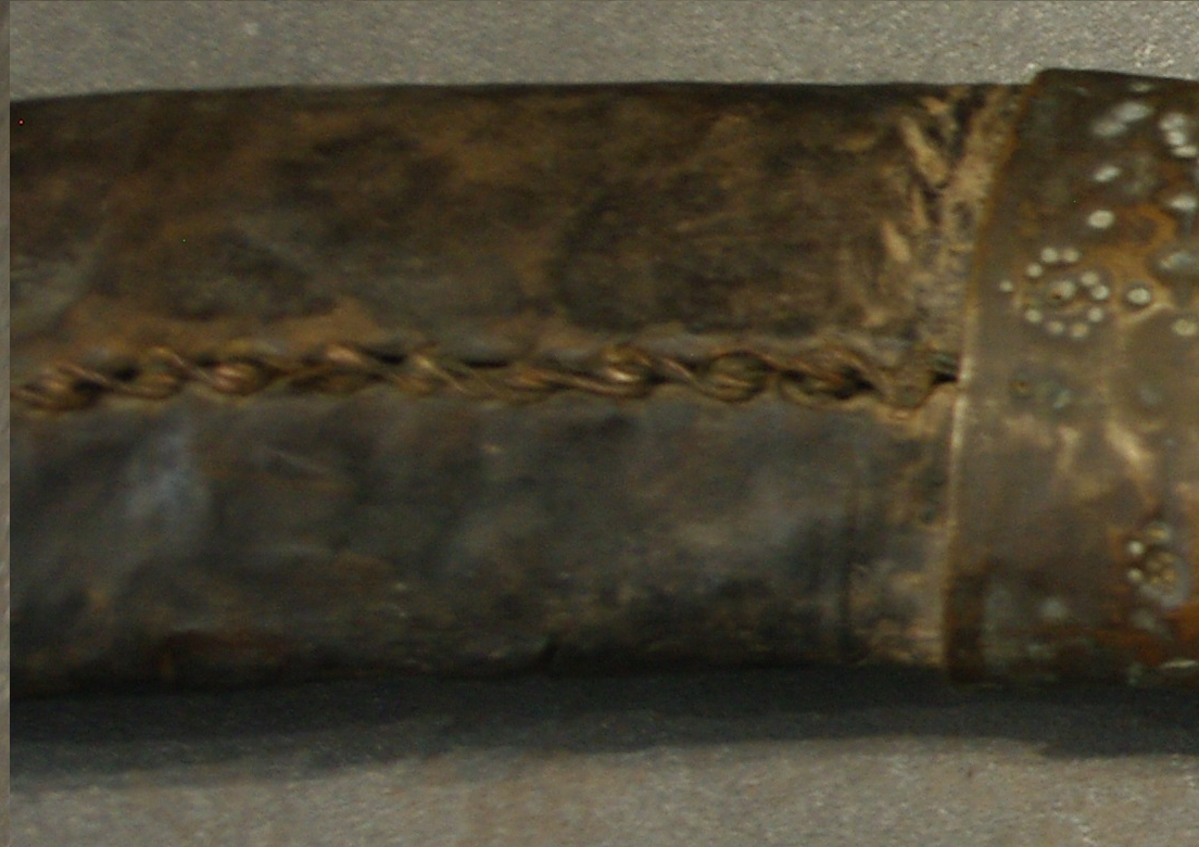

my apologies that I did not see this thread before, so hence this late reaction:
this is a Balkan weapon, either call it a small yataghan or big bichaq from the former Yu.
These are often found on offer in Croatia and sometimes in Bosnia and are crude and less fancy than the Bosnian white (bone ) ones.
I refer to my article some time ago explaining the yataghan thread
http://www.vikingsword.com/vb/showth...ataghan&page=2
in # 64
Unless it is a marriage between scabbard from ex Yu and a Yataghan from a neighbouring country; but why do that?
It is most likely made for a footsolder or some one from the country side or border guard ( granicar ). The scabbard is the give away: you can compare it with the scabbards in the many pics on bichaqs and yataghans of my threads.
Although a little poorly executed (perhaps an apprentice or not a pro trying his best) . The black paint might be protection for the grip or just to give it a black horn look a like.
Nevertheless a nice piece for each collection!
Piece of advise: the grip and scabbard (non metal piece) need some restoration to avoid drying out and detoriation.

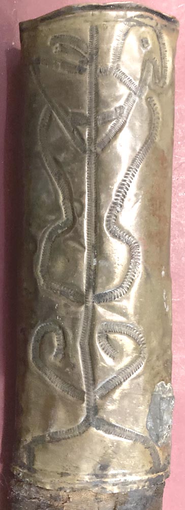

I would remove Turkey from the list of potential sources of origin.
1.The so-called Auspicious Incident ( 1826) destroyed the Ottoman Janissary corpse and initiated persecution of the remaining ones. Thus, the demand for yataghans dwindled in Turkey proper. However, manufacture of bladed weapons of Ottoman style persisted unabated in the already independent Balkans even in the early 20th century.
2. The date on the blade is given as Gregorian, not Hijjra ( Athanase’s example).
3. Numerals are European, and the crossed 7 is also very European feature.
4. The “zigzag” decoration in various forms, locations and complexity are often seen on very simple “village-produced” Balkan weapons ( see Tariq Koze “Balkan Arms”).
These considerations shift the usage of yataghans from Anatolia to “Rumelia”, ie. the European, specifically Christian, part of the former Ottoman Empire, most likely the Balkans where the Ottoman-style weapons became in fact, truly indigenous over several centuries of Turkish rule.

A good example of a “Zigzag” decoration vs. RobT’s one. Virtually identical.
Old 19th July 2022, 01:30 AM   #21
Posts: 7,403
I have looked at this and the decor - I'm leaning toward one of Ariel's choices of Syrian, though I'll also admit that this style of zigzag chasing is common (also as Ariel said).

I would be willing to bet that the culture that produced your long bichaq also made my yataghan. Although the design on your sheath differs from the one on mine in subject matter (whatever those subjects may be), the method of execution and, most importantly, the "feel" that both designs share, appear to me to be unmistakably of the same culture.
Sincerely,
RobT

I agree and really think it is from the Balkans. In my 5 years of collecting only yours and mine surfaced. Mine was bought in Souther Dalmatia / Croatia but still one must not jump to early to conclussions. Fact is that as they are simple weapons, no discriptions will pop up in literature ...
Nevertheless you've got a very nice piece!
