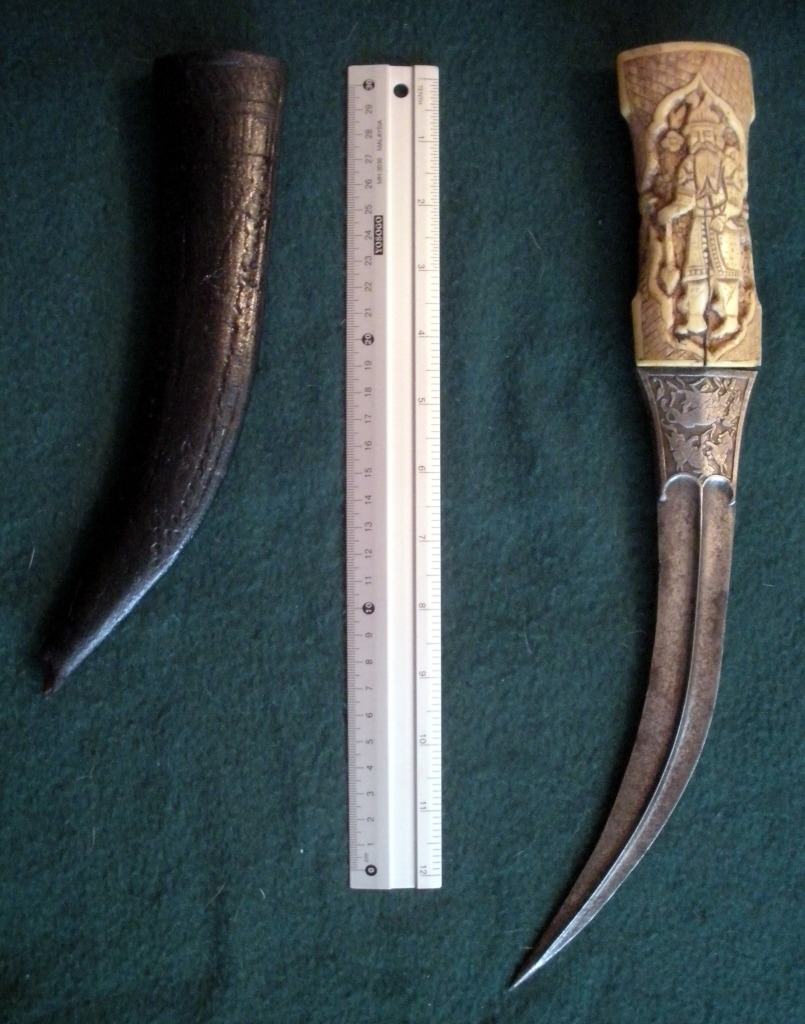

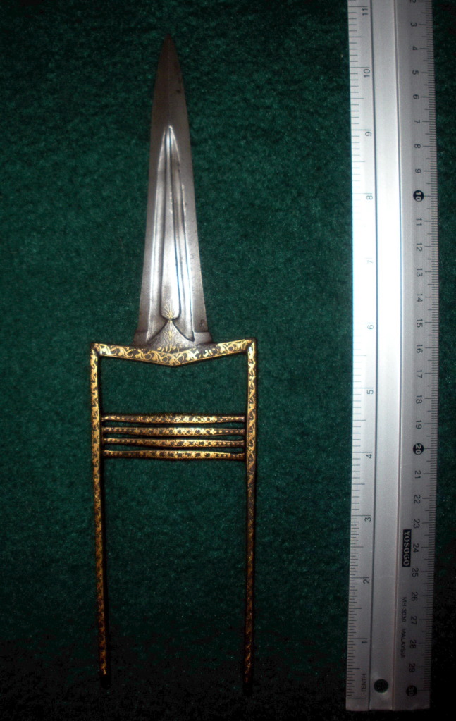

Hi Guys,
I recently bought some stuff that caught my fancy, for desk ornaments mostly.
OTOH, the source for these was a well-known collector's cache. He used to travel and collect ethnographic weapons from across the world. As such, and since my forte is european weapons, and that freely admit to know zilch about ethno blades, I decided to ask your opinions on such.
Meaning, I have been wondering if what I bought was of a better grade that I suspected, or if they truly are tourists trinkets. Mind you, the only reason I have to suspect their touristry raison d'etre is that they are too...pretty.
Best
Manolo
Enclosed are some pics of the blades in question:

Yup, tourist junk - I'd gladly take it off your hands, and even pay the shipping cost for a parcel from PR.
Now seriously, all of the items appear to date back to at least the 19th century and to be of above average quality, and certainly meant for use within the culture. Defeinitely not souvenirs.
You might want to try etching the blades as there is a high likelyhood that they may be made of wootz.

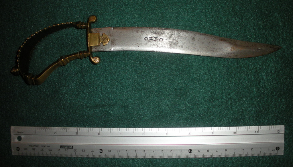

You pick up some very nice pieces. The khanjar is Persian the bichwa is mid to late 19th century and the katar is 1830-50 with nice koftgari blade is most likely wootz.

The persian blade might be wootz too. Most of them with such sculpted handle are.
The katar koftagi seems a bit unusual. Would it be possible for you to show a closer view ?

The jambiya looks too decorated to be...real? I just don't see a persian chieftain carrying it under his belt. I understood that muslims are loathe to depict human form in their art. The figures appear to be of the assyrian-babylonian past, not muslim at all. Nonetheless, very appealing art. Buffalo horn?

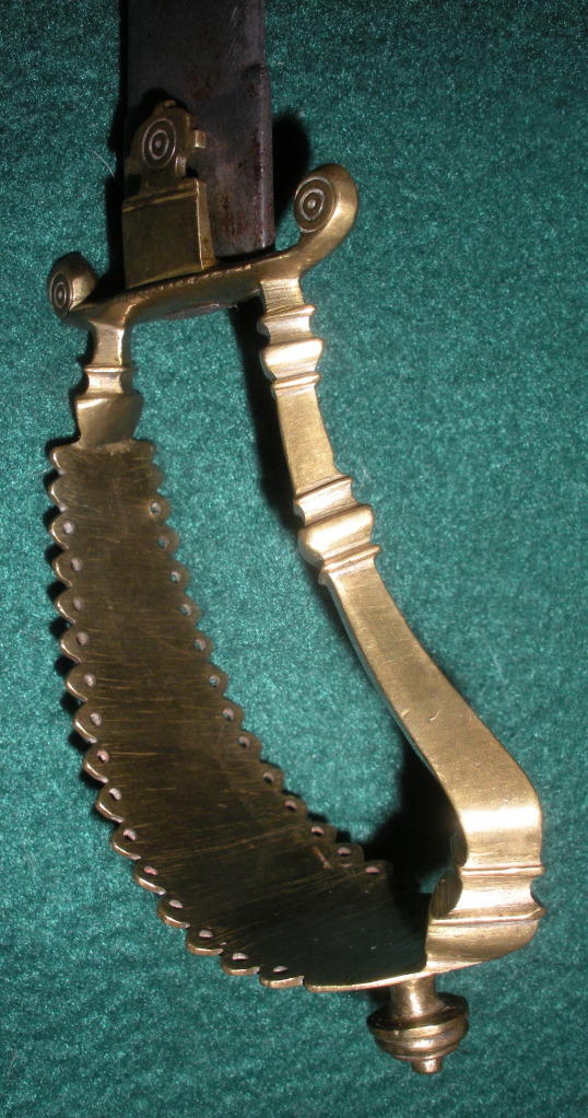

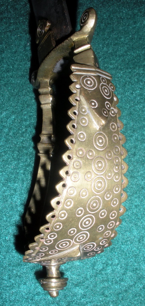

Also, the Bishwa's blade attachment to the brass hilt looks too flimsy to be useful as a weapon. A strong hit could presumably separate both. Its blade is single, and the orientation runs parallel to the plane between handle and knuckle-guard, while the bich'hwa blades I have seen are perpendicular to it.
The katar handle is very ... narrow. I don't see how an adult could grab it effectively. Is that copper or brass inlaid into the handle?

Khanjar or jambiya? What's the difference?
koftgari? Hmmm,,,AIK the blade is...gorgeously beautiful.
What about the symbol on the bich'was's blade? Talismanic, or maker's mark?

It's quite easy - you wash the blade and rub it with alcohol to make sure it is as clean as it can get, and then you dip it in some acidic solution. I prefer diluted vinegar: 1 part vinegar to 4 parts warm water. Then take out of the solution as soon as you are satisfied with the resulting pattern (assuming there is a pattern - keep in mind that sometimes the blade is plain steel and therefore there would be no pattern), wash with soap and dry thoroughly. If you search the forum, there are lots of threads on the subject.
The human effigies are typical of Persian art. I am not sure if it has anything to do with the Shia affiliation of the large majority in Persia, but it appears that living creatures depictions were not a tabu there, as opposed for example to the Sunni Ottoman Empire. I am not sure what material the hilt is made from, but it looks like bone from the picture - a pic of the pommel might help determine whether it is bone or ivory. Certainly does not look like bufalo horn.

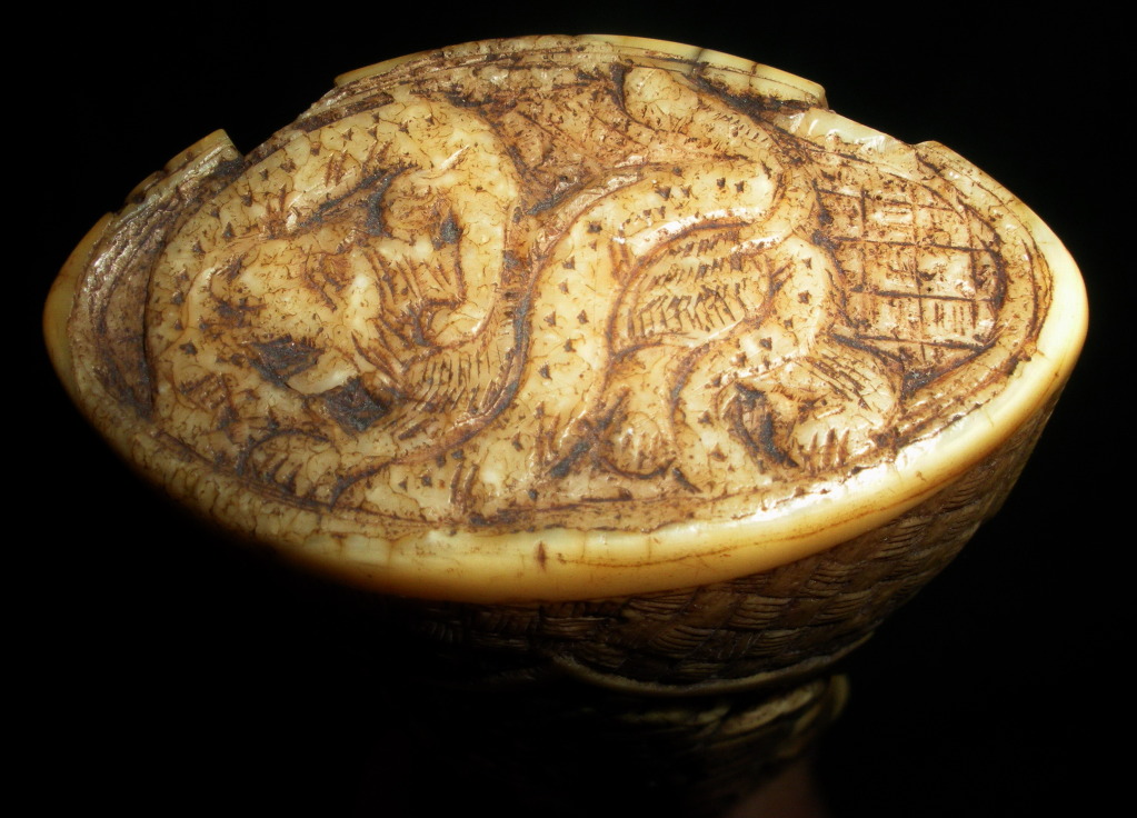

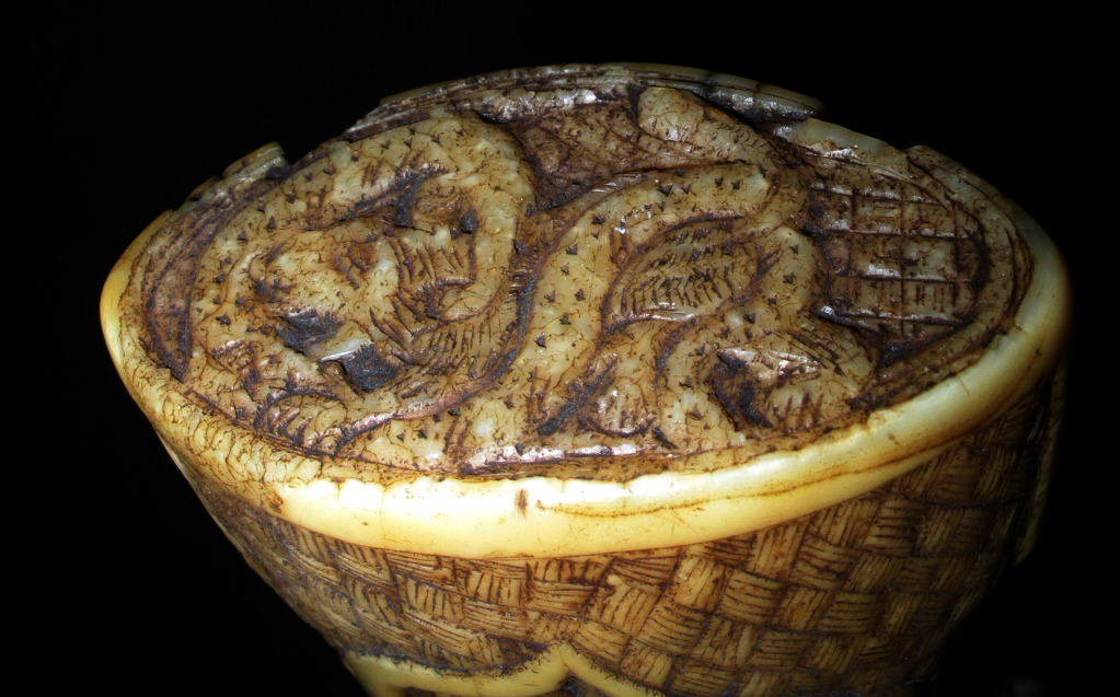

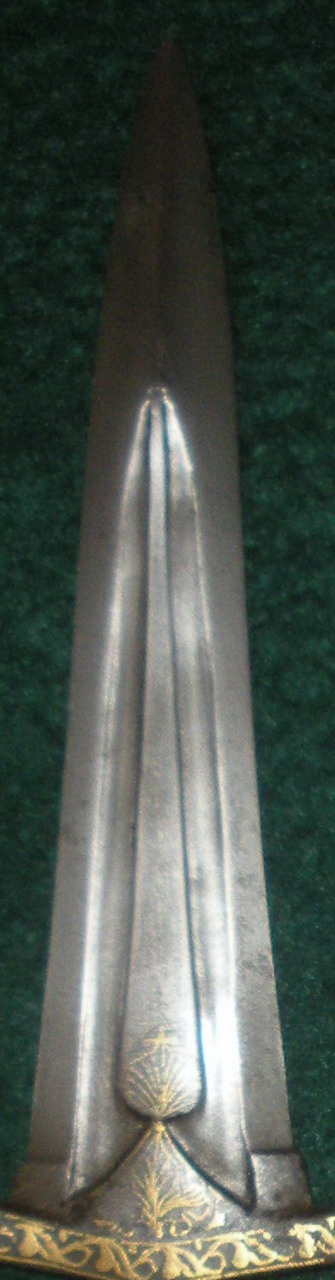

Pics included

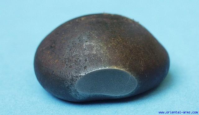

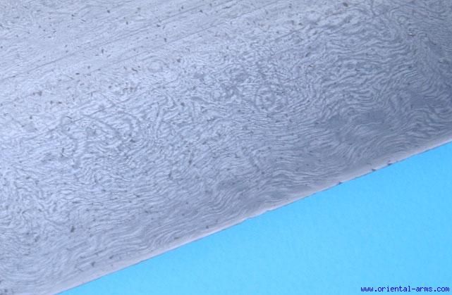

I'll try to address some of your points.
The narrowness of Indian hilts has been discussed many times. In most cases we can either accept that the people who intended to use the katar (jamadhar) were of smaller stature, with smaller hands. In some cases also note that weapons were made for children.
The khanjar is representative of Qajar era styles. "Jambiya" was historically attributed to the Saudi/Yemeni variety of curved daggers. Khanjar is a broader term used in Oman and other Arab speaking or even Muslim countries outside the Arabian Peninsula.

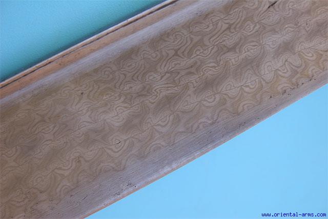

About wootz, while there may be evidence of its use by Vikings this was very limited and through trade. Perhaps you are confusing with pattern-welded "damascus". Damascus is often used as an umbrella term for most any metal with a strong pattern. It can be mechanical or chemical. The first consists of forge welding steels with different carbon contents, twisting and folding them in order to produce a more or less homogeneous bar of steel with the same carbon content all the way through. When etched, the different types of steel show a different shade, depending on carbon content. This technology was indeed used by Celts, Vikings, and almost every other steel using culture on the planet.

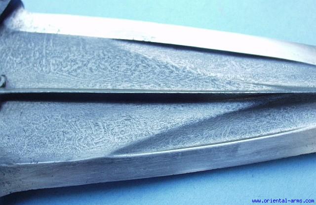

The second, wootz, is "crucible steel" or essentially cast steel first produced in India ~2000 years ago. The cooling cycle of molten steel was controlled to produce a very specific crystalline structure in the steel. The pattern comes from this chemical structure, not from the mechanical welding of different metals. It was completely homogeneous and very hard.
Hope this helps, all of these points have been discussed many times on the forum and there are lots of threads on wootz and Indian weapons.
Emanuel
- Some pics from Oriental Arms -
The top one is a wootz ingot
The next two pictures are of wootz katar (jamadhar) and shamshir blades
The bottom is of a pattern-welded yataghan blade with the "Turkish ribbon" pattern

Thanks for the pictures Manolo,
To me the hilt material looks like walruss ivory from the close-ups, as I can see the inner dentine part in the middle of the hilt.
Old 17th December 2010, 09:37 AM   #14
delor
Location: Marseille - France
Posts: 73
Yes that is walrus ivory, which was the most usual material with this kinf of dagger.

Interesting, I would have thought that walrus would be a rare animal in those latitudes. Thanks!

Yes the walrus is more than rare in Persia, but walrus ivory used to come Russia.

Walrus was traded all around the area from Russia.
