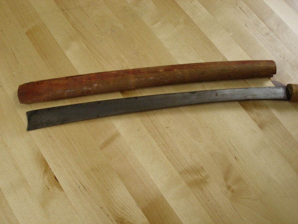

Here is a simple little dha. Shan or kachin burmese I guess. I like the tip and its curvature.
The blade has a 1cm spine at the handle, tapering to 2mm at the tip. Handle and the scabbard - which does not look original to the dha - need new rattan rings. i have looked over the old tutorial threads and I'll try to make new rings.
Thoughts on this dha?

The blade looks like a Kachin style blade, but I don't think the scabbard is original as you note. The scabbard would more likely be a half scabbard, with the back portion closest to the body open, or a more rounded scabbard.

Anyway, I'd guess it's a Thai dha/daarb. They occasionally have the square tip as seen on yours. The mounting is more distinctive, and it's similar to one I have.

I'd agree this could be a thai darb with Hua Bua Tad, or Bruman from the kachin hils. While this may not be the original scabbard I believe it is in the same style as the original But Mark, Andrew and Ian will know more. Since it widens as much as it does towards the tip I'll bet its the latter.

I bought a nhtu with a blade that widens towards like this in the market at Maymyo several years back. I'm not sure if the blade was made by a Kachin, Shan, or Burmese smith, but there definitely Kachins living in the area. Of course, I've seen square tipped blades like that in Northern Thailand as well, ad the handle doesn't look like a lot of the ones I've seen in Burma, but the most of the ones I've seen are work blades.

The tip is actually concave, more like Hua Tat Khong I guess. I've added a few more pictures.

I agree with fearn & JT that this is a Shan/Tai Yuan daab. A Kachin nhtu would have a nearly straight blade, and a shorter handle. The scabbard is Shan in style, but as others have pointed out, is very likely not original to the blade.

It is very hard to define an 'ethnic' origin for swords in continental SEA, as people use whatever is available, or whatever suits their personal fancy. Thus, you see Shan bearing Bama-style dha, Bama with Kachin, Kachin with Shan, etc., etc. The lines are especially blurred between the Kachin and the Shan. So, it is indeed impossible to say whether this dha was owned or made for a Kachin versus a Shan. I am only saying that it follows the Shan style in having a more curved blade and a longer handle. At the least, the concave tip shows Kachin influence and the blade may well be Duleng, who are well-known for their sword-smithing expertise and whose blades were traded all over the northern areas of continental SEA. C.f., Leach, Political Systems of Highland Burma, pp. 233 & 251 (1954).
Egerton describes the "sword dao" as a very heavy weapon, which this does not seem to be, another reason why I put it in the "Shan" column stylistically: "This is a long pointless sword, set in a wooden or ebony handle; it is very heavy, and a blow of almost incredible power can be given by one of these weapons." Egerton, An Illustrated Handbook of Indian Arms, p. 88 (1880) [note: Edgerton later defines a different type of sword as a "cutlass" with a curved blade, by which I interpret his use of the word "sword" to mean a more-or-less straight blade]. I have linked in below photos of a few swords that fit Egerton's description nicely.
