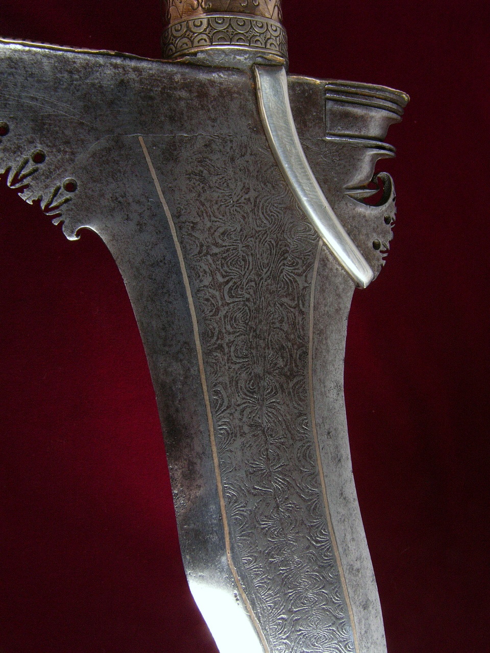

kai 14th March 2008 10:34 PM
BTW, here's an example of a Moro kris with true pamor:
(Courtesy of Bill's collection .)
http://www.vikingsword.com/vb/attach...chmentid=27858
