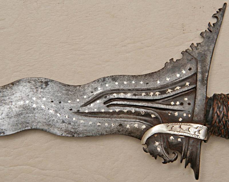

Maybe we could have this thread to gather meanings of different Talismanic inscriptions (inspired by Bill's Metaphysical thread)?
My contribution is this, quite often seen, inlay on a Moro Kris.
I haven't found out the meaning of it yet, have you?
Jim McDougall 7th December 2006 02:00 AM
Hi Michael,
This is an excellent topic for a thread!!!
Unbelievable though that there are no responses from the Keris Kadre' out there to say more on this unusual marking!!:)
C'mon keris guys, I'd like to know more on this, and hopefully some more markings for discussion.
The subject of talismanic markings on ethnographic blades is pretty vast, so I know there should be lots of entries.

VVV 7th December 2006 11:22 AM
Kai,
On your Luma the vegetative vine motif usually represent the creative forces.
The end looks like a rounded version of the old trident symbol.
Probably it's then Shiva's trident from the old beliefs still existing within Folk Islam?
If so one mening of the inlay could be that it's directing strong metaphysical forces towards the direction of the point (=opponent)?
An alternative meaning I have heard is that some people think it's a Naga and the end is a tongue?
