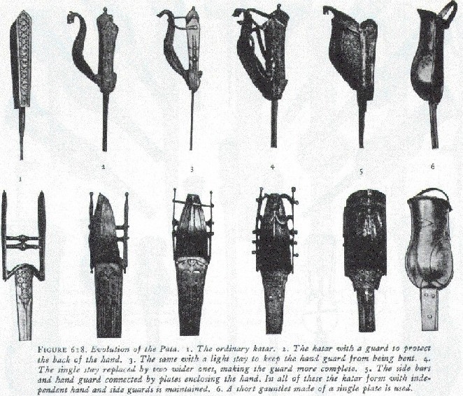

I'd appreciate your thoughts, particularly with regards to dating. I believe I've seen this more developed type with the reinforced bars across the hilt attributed to the 17th century but it would be good to have this confirmed (or corrected). It seems to correspond to stage 4 in the image below, but unfortunately the subscript does not give an indication of age:
