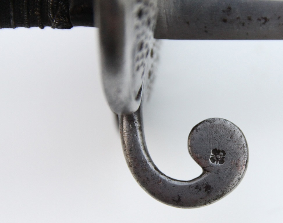

Hello folks! I was looking at H & K's tomahawk book and did see an early Dutch example with a 'flower' marking, but it had 7 petals. Still very similar...

Interesting that you mention the Dutch Jim; my mind went to the Dutch Walloon swords.
http://www.vikingsword.com/vb/attach...1&d=1478952368 |
Just browsing through Hothem (p.84) and a round eye example remarkably similar is shown as c. 1750 and with a six petal flower in this manner in same blade location, noting probable Austrian origin (no further explanation, however Seven Years War comes to mind).
