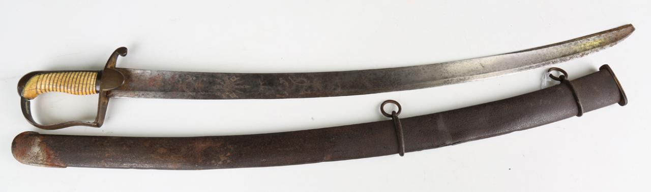

Napoleonic saber-Naval ?
2 Attachment(s)
This saber of M1796 light cavalry form seems British of course, but it seems unusual in having been gilt bronze, ivory grip, and a strange fixture on the guard which seems to be to hold a sword knot.
When I see hilts of this character in this period I think of naval officers, knowing that often they favored cavalry sabers, though there is no evidence of the fouled anchor anywhere.
What do you guys think?

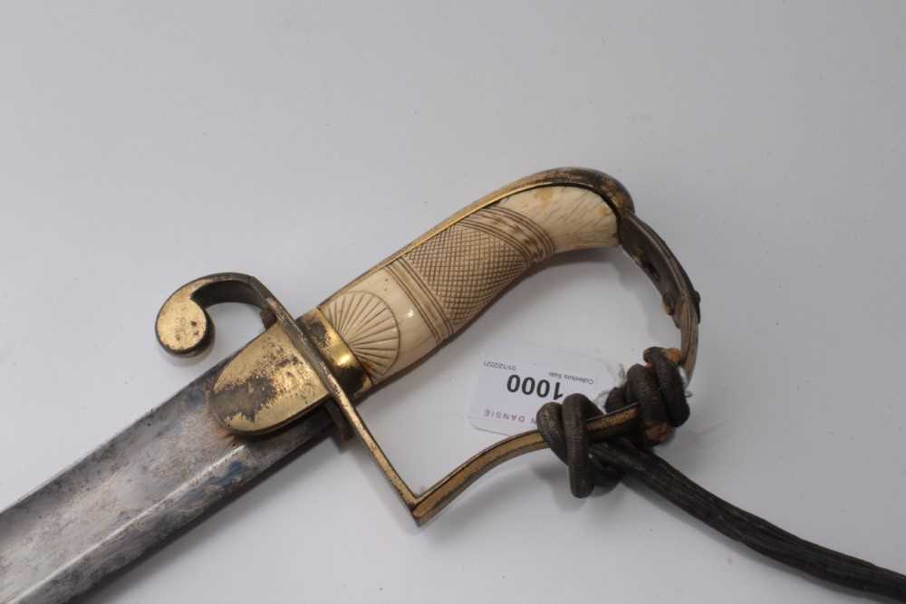

kronckew 29th November 2022 02:47 PM
1 Attachment(s)
Originally Posted by fernando (Post 276659)
...the (quote) "strange fixture on the guard, which seems to be to hold a sword knot" :o;).
he did, but it's not obvious. It's a 'staple'-like fitting on the bolster in the grip photo.
...and yes, better in your Euro forum.
Gold plating and white grip w/o the stirrups, presumably from a large grey African mammal, which for our purposes I will call a 'Walrus tooth', leads me towards a custom private purchase officer's model. I guess he didn't like using the slot near the pommel for some reason. Possibly fashion, or maybe it flopped about less if knocked out of his hand (Aboard ship? ;))

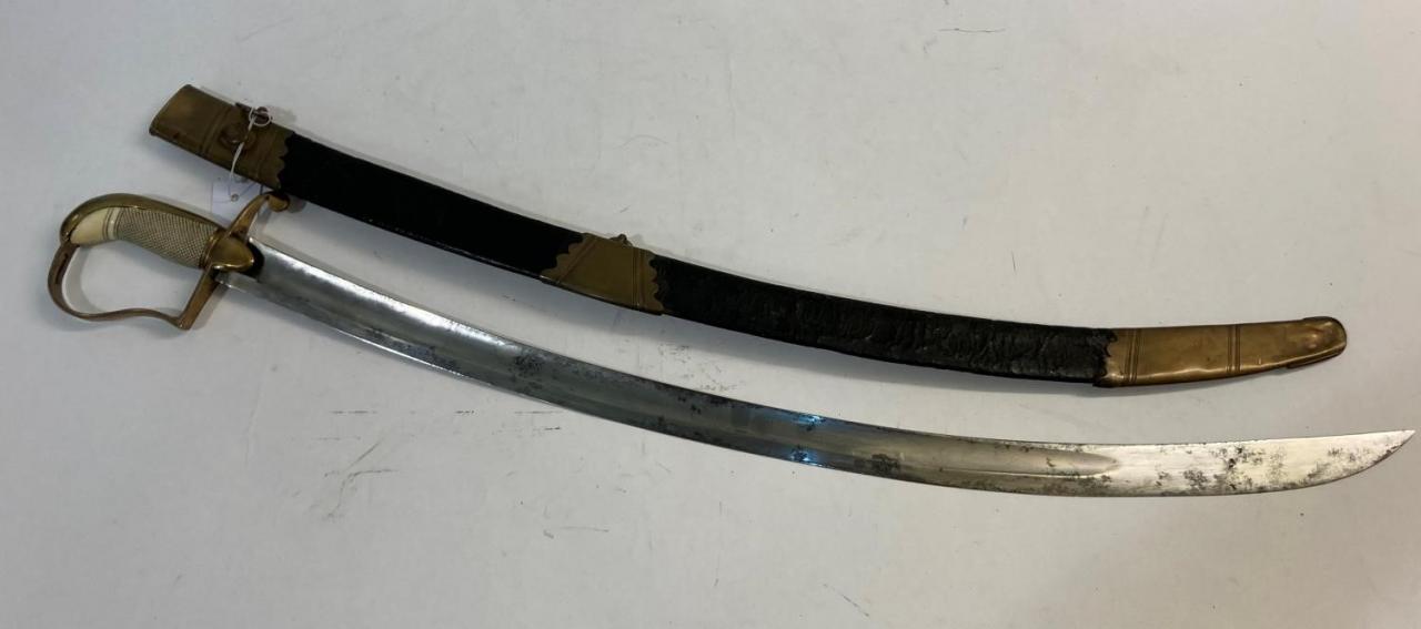

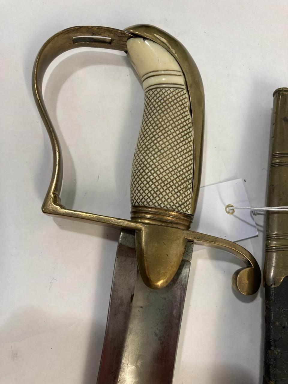

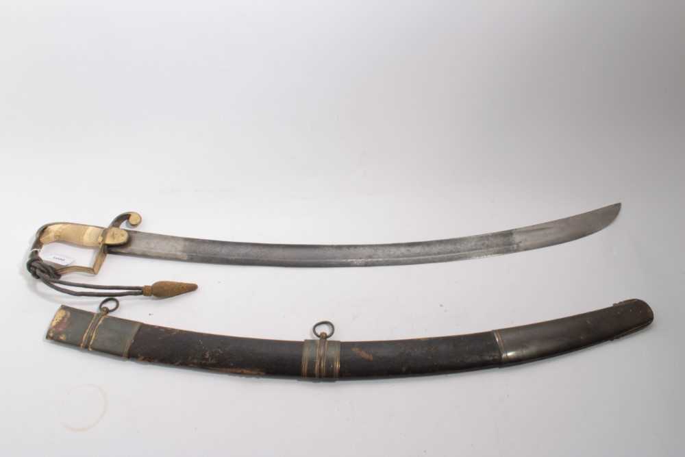

British saber-Napoleonic? Naval?
5 Attachment(s)
This is an officers saber of the stirrup hilt M1796 style and appears British, though the squared sword knot fixture on the guard apparently for sword knot seems unusual.
It seems to have been gilt bronze hilt with ivory grip which always seems to suggest naval to me, though there are no fouled anchors apparent anywhere.
This does not automatically exclude naval use, and naval officers often seem to have followed cavalry patterns in fighting swords.
I have attached a similar example from "Naval Swords & Dirks", Sim Comfort, 2008.
I would very much appreciate comments, especially on this curious fixture for sword knot which is different than anything I have seen. The gilt is mostly gone, as is the bluing and gilt motif on the blade.
In "Naval Swords", P.G.W.Annis, 1970, on p.43 (#24) is another similar example, which shows the typical manner of showing the sword knot,in the traditional manner.
As these had become decorative and in many ways status oriented, possible this 'side mount' made for better display of the often highly embellished knots Note that gilt brass was keenly preferred by officers, and they preferred longer blades than the usual hangers or small swords as noted in 'Annis'.
In remarks on this example he notes that when the M1796 cavalry saber was introduced, these were quickly copied by naval officers, and by 1805 a regulation pattern of the type was introduced.
These types with the 'birds head' pommel same as cavalry were likely the early and privately commissioned officers sabers prior to the 1805 pattern.
Radboud 29th November 2022 08:15 PM
A nice, high-grade, standard Georgian British officer's sabre is about all that can be said of it. Some general rules of thumb can be followed, such as the gilt hilt is more likely to be infantry/naval than cavalry, and curved sabres are more likely to have been carried by the 'Flank officers'.
But ultimately, with the prevalence of all the militia, volunteer and yeomanry units at the time, plus, with the habit of officers to 'do their own thing', without a solid province or identifying engravings, it is impossible to know what branch of service the original owner came from.
The lanyard 'ring' on the furrel is a common variant seen on 1796 Pattern light cavalry officers' sabres, with other another type being an integral part of the guard, extending out next to the langet.

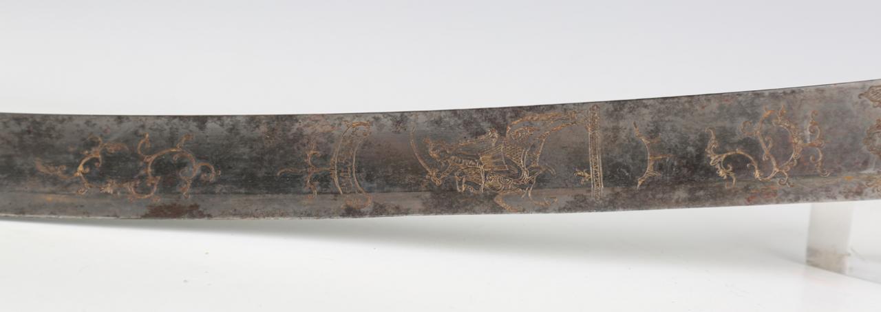

Radboud 29th November 2022 08:29 PM
1 Attachment(s)
It would be nice to see more of the blade markings from Jim's sabre, but from what I can see, they look similar to the ones supplied by J J Runkel. If true, this would date it to pre-1808.
This is one of my 1796 Pattern light cavalry Officers sabres, by Orsborn dated to pre-1800, with the same lanyard loop.

Will M 29th November 2022 11:37 PM
1796p swords with brass hilts are commonly described as yeomanry officers swords. The sword knot loop is not uncommon. I would not go so far as to say it's naval though could have been used by that branch on an individual basis.
Radboud 30th November 2022 12:51 AM
I think the ivory = navy notion is just another of those misconceptions created by early collectors and then spread by less-than-scrupulous dealers looking to cash in on a "navy premium".
It's a nice sword Jim. Is it still in your collection? Do you have the scabbard, and are there any manufacturer's marks on it?

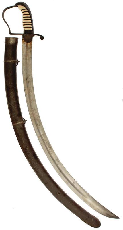

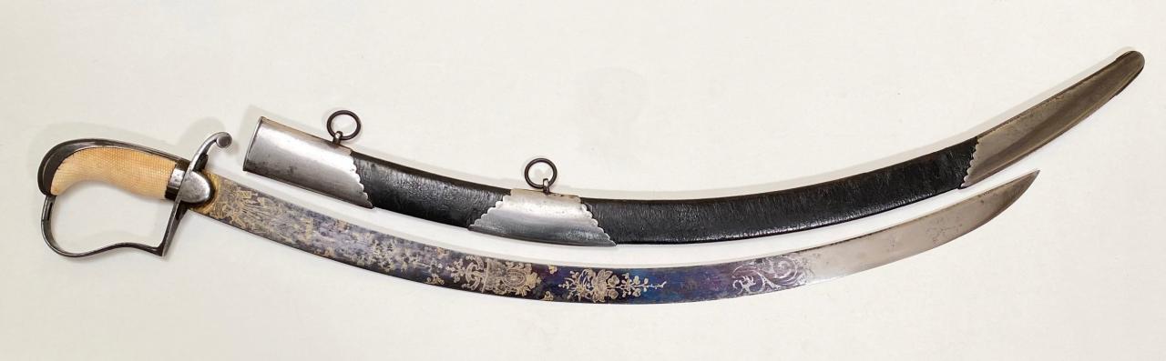

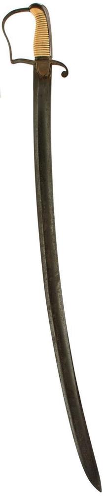

Radboud 1st December 2022 02:23 AM
9 Attachment(s)
Unfortunately, I don't have any ivory hilted 1796 style sabres in my collection, but here are some examples I've previously come across on the web:
Probable Light Cavalry Officers frock (dress) sabre. Overall length 92cm blade length 78cm.
Attachment 221544
1796 Style sabre, this one is etched with cavalryman on the blade:
Attachment 221545
Attachment 221546
Another like it with an 82.5cm blade:
Attachment 221547
Another probable Frock sword with 71cm blade:
Attachment 221548
Another, overall length is 93cm, the palm frond engraving on the grip is interesting as it's also seen on Hussar Mamelukes. A possible connection?
Attachment 221549
Attachment 221550
Another, possible Yeomanry sabre with 83cm blade:
Attachment 221551
Attachment 221552
As you can see, the type isn't that uncommon. Plus I've deliberately left out the ones with lions head pommels and embellished langets....

Radboud 1st December 2022 03:48 AM
Originally Posted by Jim McDougall (Post 276709)
The one with the deeply curved blade, rifle company?
This is one of those grey areas. The steel scabbard would be more typical for a cavalry officer as it is harder wearing for when mounted. Leather is lighter and makes less noise when walking about. The blade is short at 71cm (28 inches), not suited to mounted combat. But I've seen dress swords with steel scabbards as well.
But then an officer that could afford an ivory-hilted sword is equally likely to be mounted regardless of service, it's anyone's guess really.
Given that the British had only three (four?) Rifles Regiments in the regular army at the time, I would say on the balance of probabilities that it belonged to a Cavalry Officer.

That’s a lovely sword. How long is the blade? Do you have an image of the whole sword?
Having a small lanyard ring like that is an interesting choice. I have to wonder how well such an arrangement would stand up the the rigours of mounted combat. Of course there are practical alternatives that can be used while still retaining the ring.
The at of arms is the pre-1801 type, so while not exactly a precise measure it does help identify this as an early sabre. My observation has been that sabere blades supplied by Runkel tend to be on the larger size for dismounted or purely dress use.
Jim McDougall 9th February 2023 06:05 PM
Very nice!! Note that in the coat of arms, the three fluer de lis in upper right quadrant are present.....this theoretically changed in 1801, so presumably this is pre that 1801 date. However it is quite possible that technicality was not readily observed, and that blades on hand with cutlers and outfiitters might have been used later.
kronckew 9th February 2023 07:25 PM
1 Attachment(s)
In 1801, when George III renounced his title as King of France under the Treaty of Paris, the French Fleur de Lis quartering was removed,and replaced with the Scottish Lion.

late 18th Century British Sabers
5 Attachment(s)
As requested, here are photos of the whole sword. the blade is 32.5" and the overall length is 37.5" This sword has a milder curve than a similar lion headed saber it sits next to on my shelf (blade 30", overall 35.25"). I added photos in case you are interested in seeing both. The second sword is blued with gold for half the length of the blade, and has a very fancy brass guard.
Radboud 10th February 2023 07:29 AM
Thank you for the additional photos, at 32.5 inches thats the standard length for the 1796 Pattern LC. So your’s is most certainly a cavalry officers, most likely from the Yeomanry, given the guilding.
Your other sword is the 1803 Pattern ‘Flank Officers’ sword. The flank companies were the Grenadiers and the Light Company that marched on the flank of the regiment. These were seen as the regiments’ elites with the Grenadiers often at the front and in the thick of battle while the Light Company ranged out, scouting ahead and skirmishing with the enemy before full engagement by the regiment. From 1800 the officers of these companies were given permission to carry sabres (a habit they had already acquired) in place of the 1796 Pattern infantry officers sword. Drawing on the ones that were popular in 1803 an official pattern was declared with a lions head pommel and GR cypher for the guard.
Lots of variation exists in the grips, with leather and shagrin being most common, but ivory and wire grips are also found. Because the hilt is the pattern, there is a lot of variation in the length and shape of the blade in these.
Of course, over time others chose to carry these swords, so it is not impossible that your’s belonged to a high ranking general officer, rather than a ‘Flank officer’.
